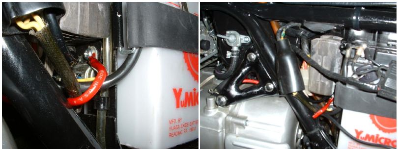

..."On a GL1000, it is very critical that your condenser assembly have a solid ground for efficient operation of the wasted spark ignition."...
http://www.randakksblog.com/gl1000-condenser-ground-upgrade/#more-610
mfG, Ruud
